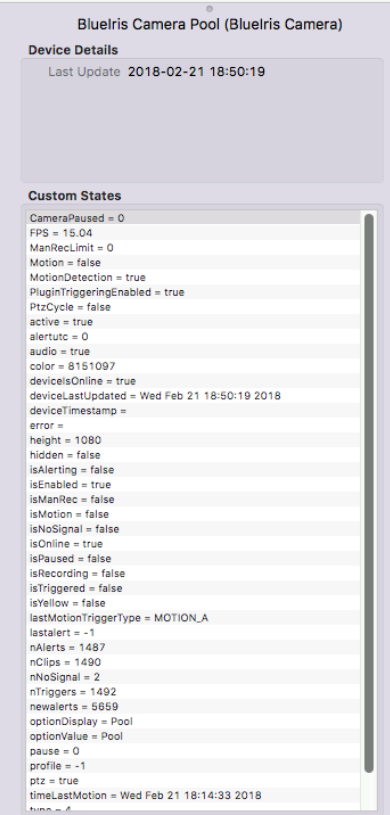

BlueIris Server device CPU, memory, disk, profile, schedule, connection count
BlueIris Camera device Motion state, recording, PTZ, plate data, 30+ live states

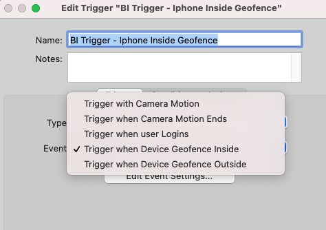

User Login A named BI user logs in
Geofence Inside / Outside Mobile device enters or leaves BI's geofence

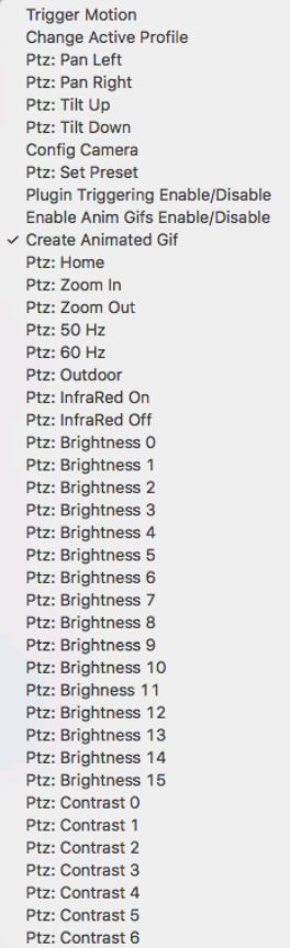

Camera control Trigger motion, enable/disable motion detection, pause, manual record
PTZ Pan, tilt, zoom, home, preset, IR on/off, brightness, Hz

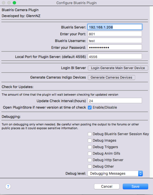

  2. Configure β€” open Plugins β–Έ BlueIris β–Έ Configure…, enter your BI server IP, port, username and password
  3. Login β€” click Login / Generate Server Device to create the server device
  4. Cameras β€” click Generate Cameras to create one Indigo device per camera

Major change is plugin built in ## Http Threaded Server
0.6.0 Change
Changes to Plugin managing it's own Http Server:
Need to put port number of server in PluginConfig:
Default port 4556
Can be changed to any allowed port if needed.
In Plugin Config select port to use and then will start its own server on this port. Will need to reconfigure BlueIris Server web requests/alerts to this server
    When Triggered
    http://IndigoIP:4556/&CAM/&TYPE/&PROFILE/True
    POST text: Indigo
    Request again when trigger is reset
    http://IndigoIP:4556/&CAM/&TYPE/&PROFILE/False
    POST text: Indigo
see here:
![https://camo.githubusercontent.com/6b17f5f6af6a53cdc448035d2af006fb7776dfec/687474703a2f2f6936382e74696e797069632e636f6d2f333061676737632e706e67](https://camo.githubusercontent.com/6b17f5f6af6a53cdc448035d2af006fb7776dfec/687474703a2f2f6936382e74696e797069632e636f6d2f333061676737632e706e67)

Add Enable/Disable Generate Animated Gifs as Action Group per Camera/s
[this enables you to change the camera settings with an action as required - e.g arrived home; stop making them]
Add Status PluginTriggeringEnabled to each Camera.
[this enabled you as an action to disable any Plugin Based triggering [this doesn't affect BI Server]
eg. arrived home - Disable this setting and no Plugin Triggers for this camera will occur]
PluginTriggeringEnabled for all Cameras reset at Plugin startup to Enabled.

  • Clips
  • User - Reported Username from BI
  • Latitude
  • Longitude
  • Version - BI Version Number
Add States to BI Camera Device
  • Camera Motion Detector On/Off True/False
  • Camera Paused -1,0 as per BI
  • Camera PtzCycle active True/False
Some of these states require the Indigo Plugin BI Username to have admin rights on the BI server. I have added quite a few checks to capture when they are not, even if changing back and forwards without restarting. If you don't want to be a BI Admin user - thats fine - the these new states will remain blank.
